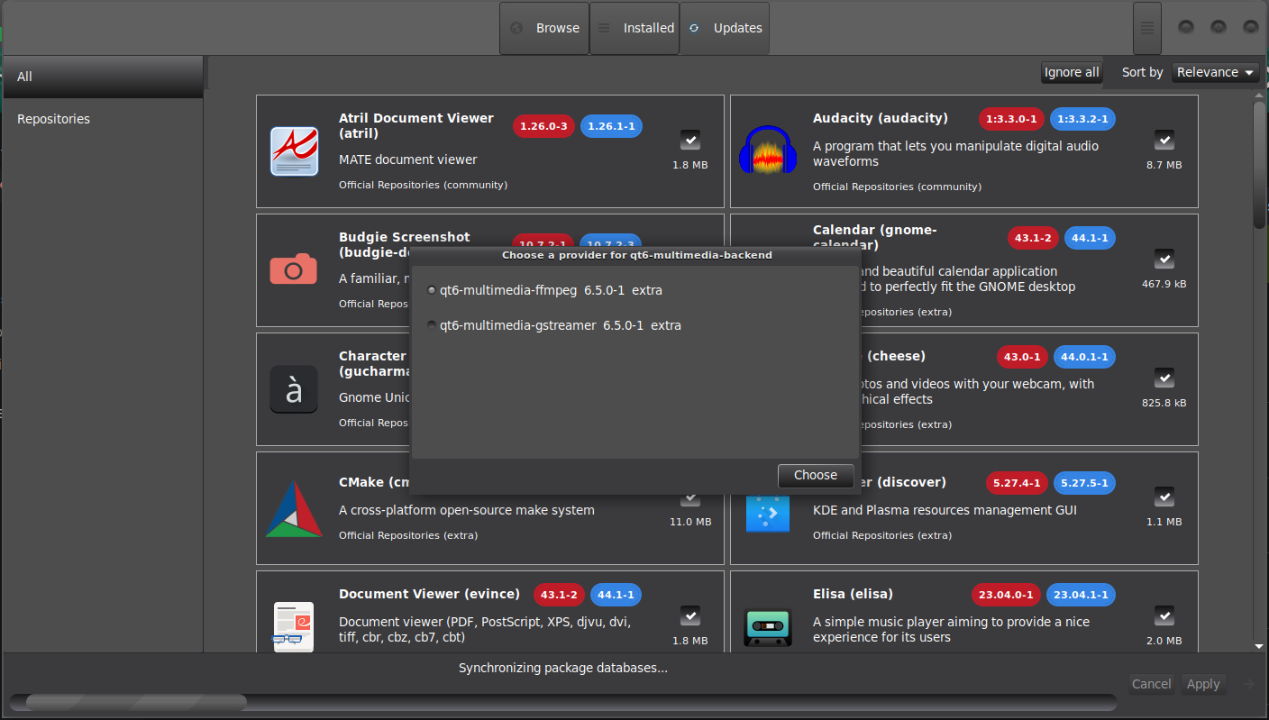

Failed to update
Some help to solve it?
Thanks in adcance

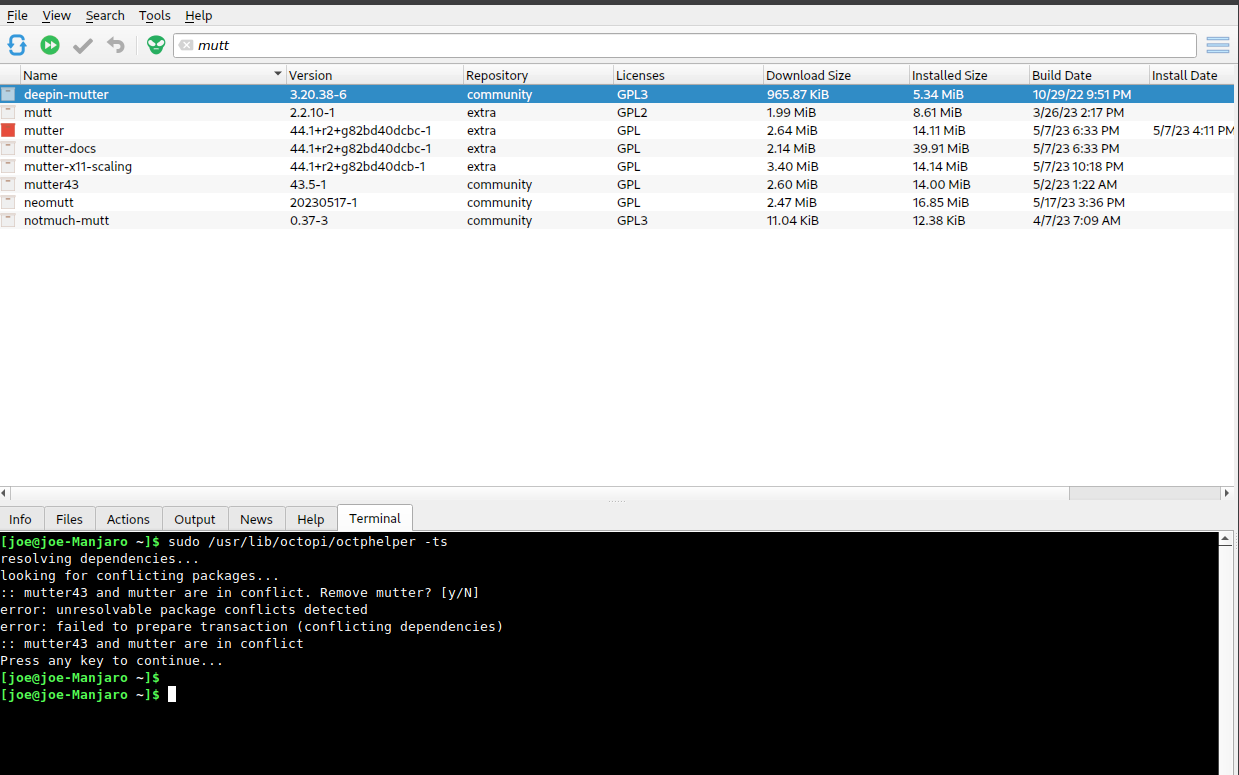

It depends which desktop environment you are using. Only Budgie seems to need the older mutter from 43 series …
I use mate so i delete mutter and the update finish without any error.
Thank you!

The fact that I have (mate-gnome-cinnamon-Budgie) DE installed on my system I believe is the cause of dependencies and sometimes unsolvable is the reason I do not recommend it to anyone (many DE) and the reason that in the future I will I have other problems. Thanks for understanding
