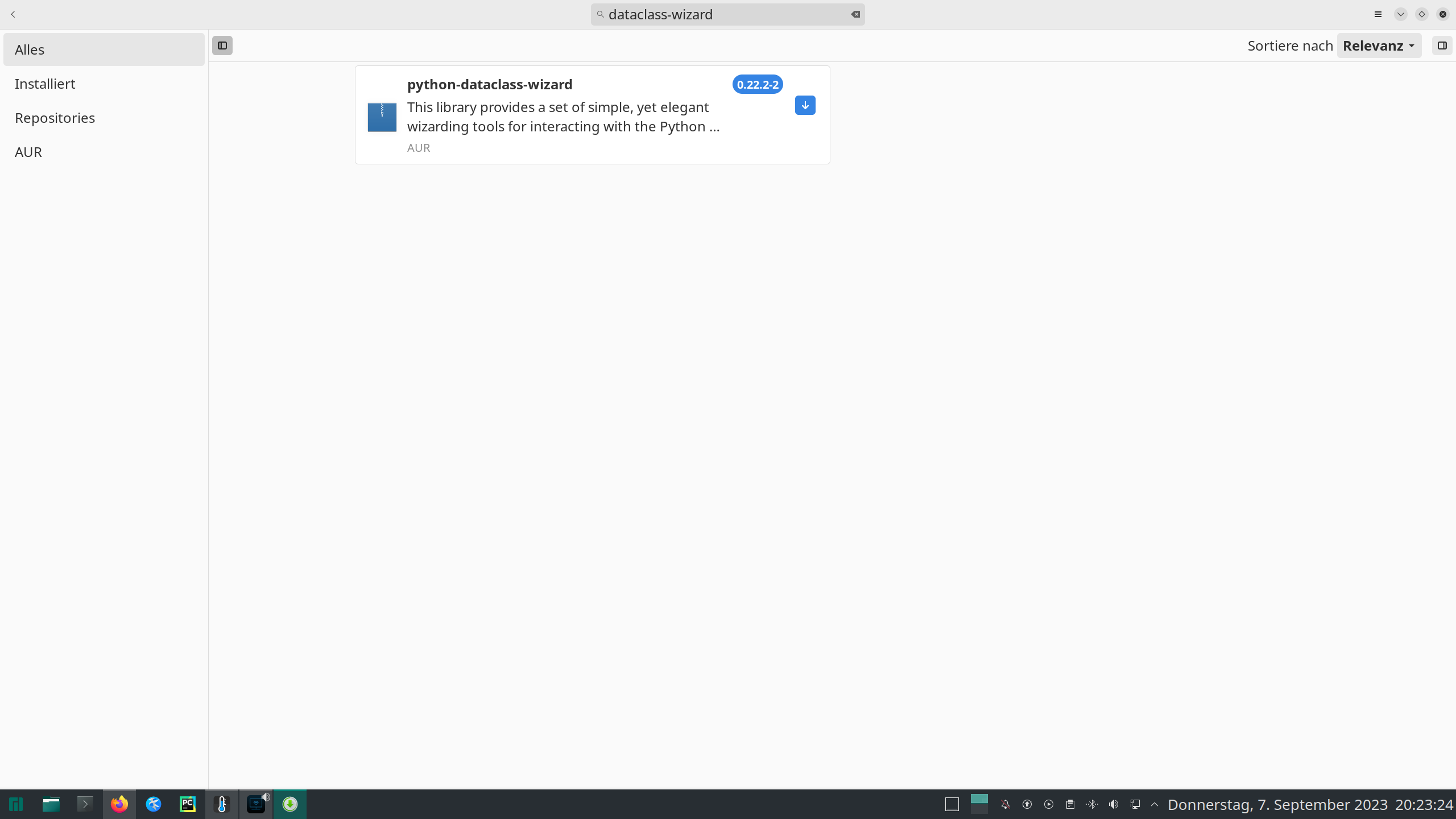

pip install dataclass-wizard
That was one reason I kept Manj :frowning: It was so easy installing stuff using it.
pip install dataclass-wizard                                                                   ✔
error: externally-managed-environment
× This environment is externally managed
╰─> To install Python packages system-wide, try 'pacman -S
    python-xyz', where xyz is the package you are trying to
    install.
    If you wish to install a non-Arch-packaged Python package,
    create a virtual environment using 'python -m venv path/to/venv'.
    Then use path/to/venv/bin/python and path/to/venv/bin/pip.
    If you wish to install a non-Arch packaged Python application,
    it may be easiest to use 'pipx install xyz', which will manage a
    virtual environment for you. Make sure you have python-pipx
    installed via pacman.
note: If you believe this is a mistake, please contact your Python installation or OS distribution provider. You can override this, at the risk of breaking your Python installation or OS, by passing --break-system-packages.
hint: See PEP 668 for the detailed specification.
well it seems it’s more easy you were thinking. this message tells you to install it system-wide, that’s nothing else than open the package-manager again, and you’ll see
It is already there :frowning:
I guess that’s why Yochanan said before that the AUR maintainer should be informed about that problem.
Github asks my phone number to sub which I am not willing to give to everyone so I will not be able to report this.

So this is how Olli helped me to get it to start:
  • uninstall coolercontrol and dataclass-wizard in the package-manager
  • open the package-manager and search for “linux515-headers”. if not installed then install it
  • check for “base-devel” and if it is missing install it.
  • Open a terminal/console and run sensors-detect. Always type yes and follow the procedures. this application will detect the sensors and will create a configuration that the coolercontrol application will need later.
  • The next step is to build the packages. This means they will be compiled from source. We have to do it for both. Open a terminal and first run ´pamac build python-dataclass-wizard´
  • Next is to do the same with the cooler-app. I checked it and it has to build a lot of additional things so take a MUG of coffee (a large one) or a cold beer because it takes time. It can happen that this will stop because if there are packages missing (i doubt it’s rust). Don’t worry, we will do a simple test (top or flop and we’ll see if it runs smooth). let’s build “pamac build coolercontrol”.
  • Now reboot and check if these two services are active ´systemctl status lm_sensors.service´ and ´systemctl status coolercontrold´
  • open a terminal and start coolercontrol
