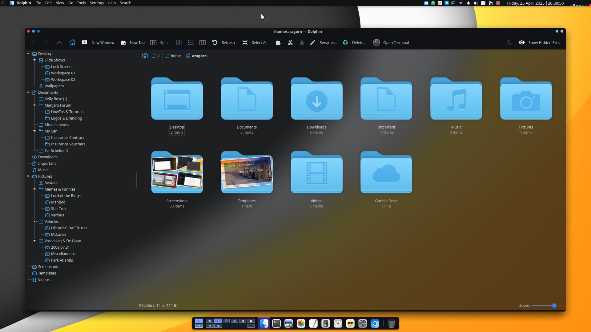

As I regularly check out new themes at store.kde.org, I noticed that in the screenshots of modern themes, the dolphin panel with the folder list does not have alternating backgrounds as on mine. :point_down:
I’m not sure anymore when exactly this alternating background was introduced, but it was somewhere during the time of Plasma 5.2x.x. I accepted it at the time as a change from upstream, but I’ve never liked it, and now that my eyes are getting a bit older again, I find that it’s actually counterproductive.
It does not appear to be theme-dependent — it appears in multiple themes — and I’ve looked all over the dolphin settings and the kvantum settings, but I cannot find any setting pertaining to this alternation between a dark background and a translucent one.
It’s also not in the color scheme, and for two reasons…:
  1. My color scheme shows them both to have the same color.
  2. kvantum themes don’t use the color scheme, because they are SVG-based.
Apparently there is a way to disable it, given that the themes at store.kde.org don’t show this effect, but for the life of me, I cannot find it. Ergo, I would appreciate it if some kind soul were to explain to me how to get rid of it.
P.S.: The alternation in background does not appear in the Places panel. It’s only in the folder list. :man_shrugging:

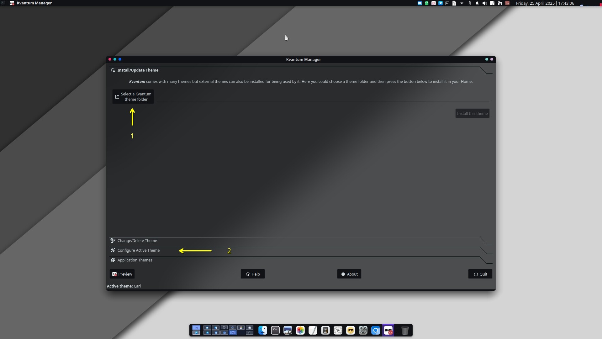

No, a kvantum theme must be loaded into the Kvantum Manager — it already contains a number of them, but if you download a new one, or a new global theme, then you must unpack the kvantum archive for that theme and point the Kvantum Manager at the folder. It will then import the theme and allow you to select it and tweak it.
You can then afterwards delete the original folder and archive.
I tried setting it in kvantum and it only applies to kvantum.
There’s nothing to select in the System Settings → Colours & Themes, apart from a couple of kvantum application themes (kvantum and kvantum-dark) and lots of kvantum colour themes.
If I select an application theme and log out and back in again then it applies the theme I set in kvantum manager. KvBrown in the pic I temporarily posted.
Yes, although you don’t have to log out. Just close the application, set the Application Style to kvantum , select a kvantum theme in the Kvantum Manager, and restart the application.
