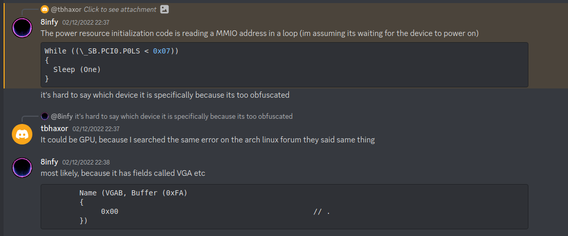

Ohk so this is linked with icons not displaying on Boot.
Where I managed to boot the system with proprietary drivers, without my external monitor attached it is working fine (also works with different refresh rates, but still I set both monitors to 60 hz). Now everytime I have to detach the external monitor, before booting it up or continuing from the sleep. With the booting I am getting following error

I had already discussed this same issue with someone on discord, and he told me this
I don’t know if its ok to tag, but @Fabby you could help me with this.
