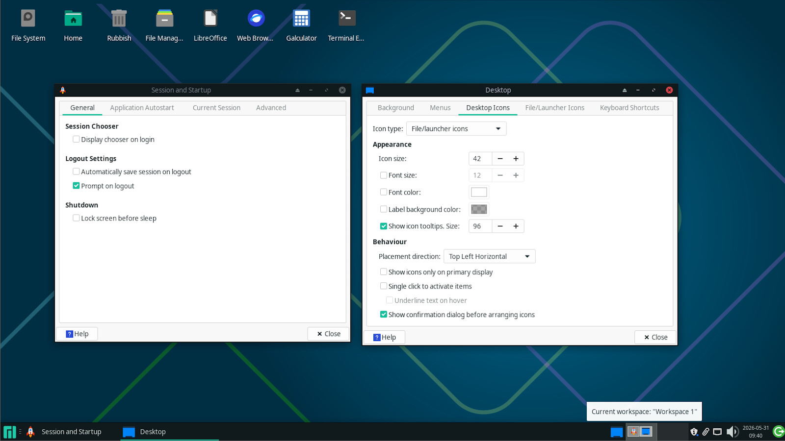

Desktop icons auto-arranging since last update
Since the last major update a few days ago my desktop icons are being auto-arranged in a column starting at top left (I can’t see any meaningful order eg date or alphabetical or folders than files).
I’ve tried moving icons and logging out then back in and things seem ok but after a reboot the issue recurs. I’ve tried doing a ‘save session’ but the same applies.
Searching the web this seems to have been an occasional issue going back years - some of the fixes suggested don’t seem to be applicable now.
Any help appreciated!

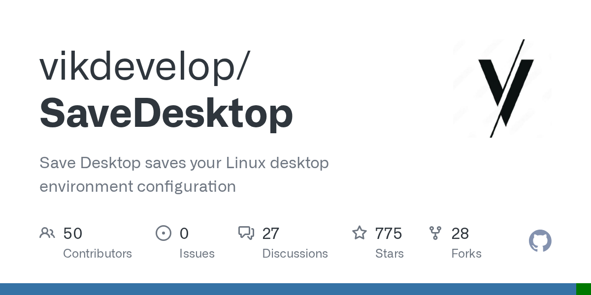

Though it doesn’t solve the immediate issue, if you are interested in a solution that not only saves and restores icon positioning, but also current wallpaper and theme configuration, then SaveDesktop might be a welcome addition:
SaveDesktop works with GNOME, KDE Plasma, XFCE, Cinnamon, Budgie, Cosmic and others; available as flatpak:
flatpak install savedesktop
In a freshly installed Manjaro XFCE VM with default Session and Icon configurations, desktop icons are restored as expected.
Compare your settings with the following screenshot;
If you haven’t played with those settings, the only difference should be that “Placement direction” is set to “Top Left Horizontal” in the screenshot.
Try duplicating those settings – specifically, uncheck “Automatically save session on logout” – and see if that makes any difference. Additionally, if you are using Automatic login, disable that first.

I’ve also already tried adjusting the settings shown in your screenshot but to no avail. I don’t want to install a third party workaround script which could introduce other bugs or become incompatible.
