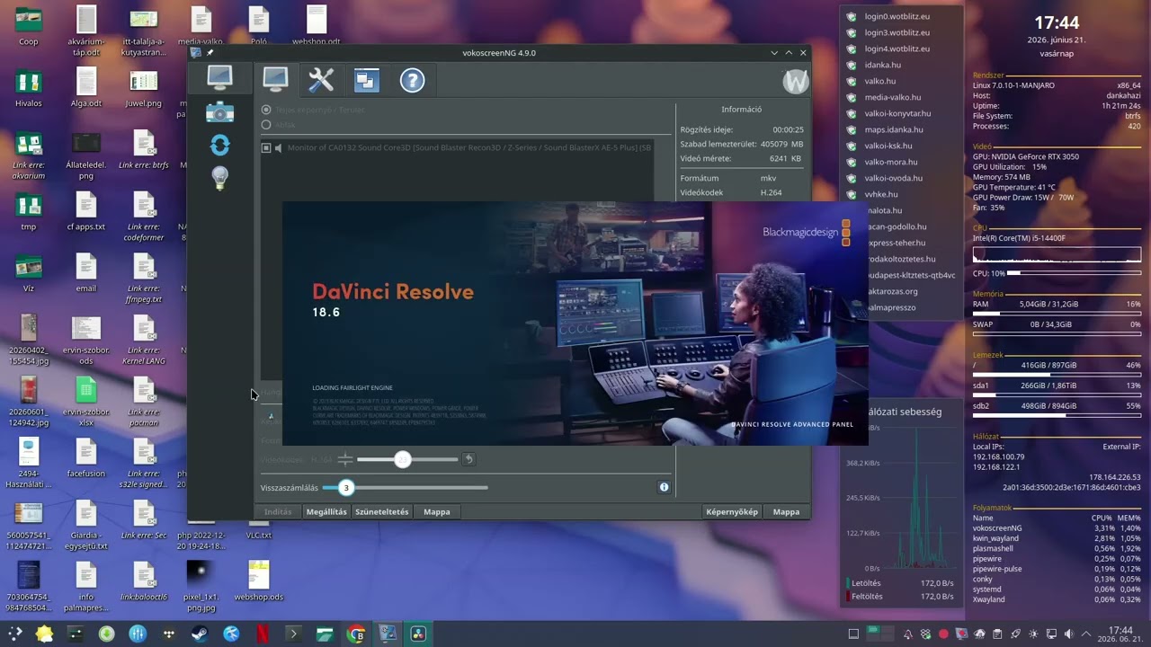

"Hi everyone, maybe someone here knows the solution. I installed DaVinci Resolve 18.6.4 on Manjaro KDE Linux, but I have no audio at all, no matter what I try.
I have already installed the following packages, but it didn’t help:
  • davinci-ffmpeg-encoder-plugin
  • pipewire-alsa
  • pulseaudio-alsa
Any advice on how to fix this?"
