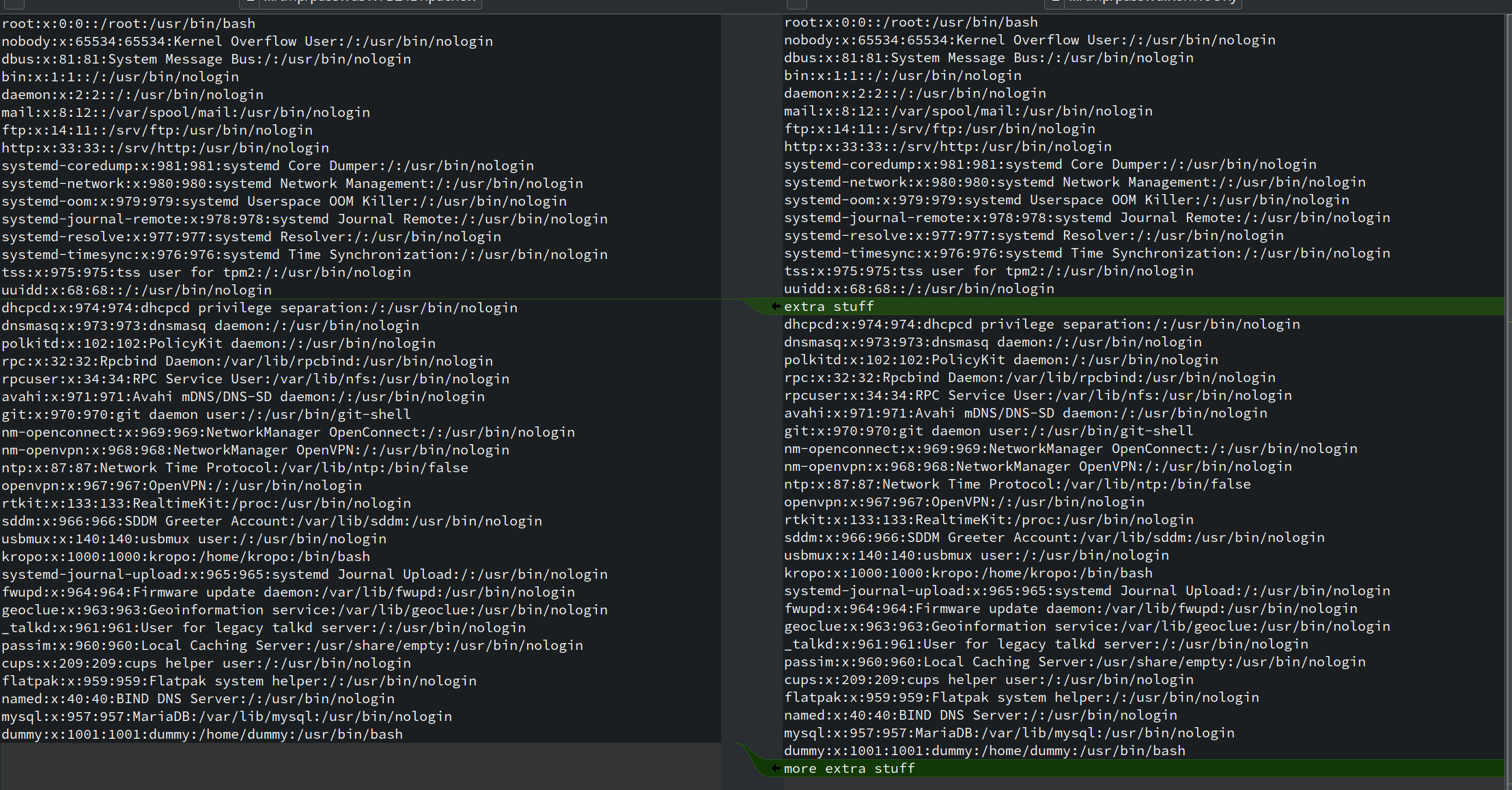

It’s not, certainly not with meld anyway. Doing a merge replaces the whole file not just that one single line. Try it yourself - let’s pretend it changed back to /bin/bash;
$ echo 'root:x:0:0::/root:/bin/bash' > passwd.pacnew
$ sudo meld /etc/passwd passwd.pacnew
See the problem? The instructions @Zesko gave are the correct way to deal with this.

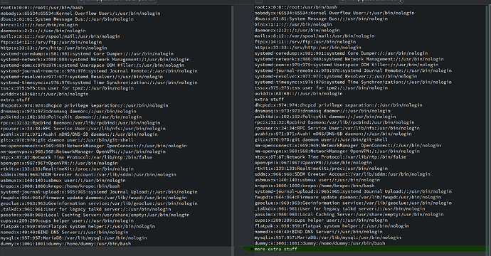

I just quickly checked out meld. You realize you can copy specific lines between two sides? Replacing is not merging.
meld can’t do the job in this case -
it will not let you replace that one line from the /etc/passwd.pacnew with the corresponding line in /etc/passwd - it will replace the whole file with that one line
… or I’m too dumb to operate the program

Thats not how its supposed to work.
And I’ve certainly used meld to augment passwd.
Are y’all using the ‘merge’ option?
I dont recommend that. The point is usually to use ‘view’ and manually do the ‘merging’.
In this interaction you can replace single lines or single terms, etc.
You can click on the arrows next to the line and selectively merge those strings, etc.
Even if that was somehow broken… you can use the interface to copy/paste or simply write out the first line (etc) if necessary.
