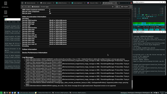

Thanks for the new chromium_v139. On kernel linux-6.16.0-1, chromium_v139 NO vpu hardware acceleration. No idea why on your opi5plus you have vpu hw acceleration with linux-6.16.0-1 but NOT on my device only noticeable difference is on your device you have EDK2 on SPI and my device joshua-riek u-boot loader on SPI. Have raised this with warpme as his kernel-6.16.0-1 also have the same issue NO vpu hw acceleration on Chromium_v138 and also the fact that mouse pointer also NOT visible with warpme kernel-6.16.0-1 and Manjaro linux-6.16.0-1 on KDE Plasma DE. Workaround:
instert
export KWIN_FORCE_SW_CURSOR=1
/usr/share/sddm/scripts/wayland-session
On linux-6.15.8-1 vpu hardware acceleration is available on chromium_v139 and is working fine so far.
With linux-6.16.0-1 “clapper” media player can most of the local 4k h264 8bit video where as on linux-6.15.8-1 the same video does works on clapper.
Edit: Thus far, with @darksky (kernel), @maxjrh (stable chromium on opi5plus) and @junari (mpv and ffmpeg with v4l2request support), mainline kernel on opi5-plus can be an option as daily driver - where GPU and vpu hardware acceleration is available (h264 and h265 8bit video).

Update on why chromium does NOT have vpu hardware acceleration on some boot up or power up on linux-6.15.8-1 (or warpme kernel-6.15.4). warpme suggested that chromium might be having vpu hardware acceleration on a specific vpu driver/firmware. He wrote a script for me to check.
echo "v4l2 video devices"
v4l2_devices=`ls -1 /dev/video*`
for d in ${v4l2_devices}; do
  echo "--------------------------------------------------------------------------------"
  echo "Device: ${d}:"
  v4l2-ctl -d ${d} -D --list-formats-ext --list-formats-out-ext
  echo " "
done
The result or finding are as follows:
On kernel linux-6.15.8-1 or warpme kernel-6.15.4-1
Chromium have NO vpu hardware acceleration on boot-up or power-up whenever
Device: /dev/video0:
Driver Info:
	Driver name      : rkvdec
	Card type        : rkvdec
or
Driver Info:
	Driver name      : hantro-vpu
	Card type        : rockchip,rk3588-vepu121-enc
Chromium will have vpu hardware acceleration on boot-up or power-up whenever:
Driver Info:
	Card type        : rockchip,rk3568-vpu-dec
On kernel linux-6.16.0-1 or warpme kernel-6.16.1/kernel-6.16.2 there is always NO vpu hardware acceleration on every boot-up or power-up as there is NO “hantro-vpu, rockchip,rk3568-vpu-dec” driver/firmware.
I think “hantro-vpu, rockchip,rk3568-vpu-dec” is needed to be patched back into linux-6.16.y in order for chromium to have vpu hardware acceleration.
Is there a way to alway set “/dev/video0” boot up with “/dev/video0: hantro-vpu, rockchip,rk3568-vpu-dec”?
Apparently mpv-full-git and clapper media player are able to use “rkvdec” for vpu hardware acceleration as vpu hardware acceleration is always working on every boot up be it on linux-6.15.8- or linux-6.16.0 or warpme kernel-6.15.4 or warpme kernel-6.16.1 or 6.16.2.

2025-09-09
Hi @maxjrh,
The upstream Debian-Trixie chromium 140.0.7339.80-1~deb13u1 and Fedora-42 chromium-140.0.7339.80-1.fc42, both chromium stable on Opi5plus and have vpu hardware acceleration.
Fedora-42 kernel-6.16.4 only have hantro vpu driver.
The latest Armbian kernel-6.16.5-edge-rockchip64 have both hantro-vpu and new rkvdec driver which support hevc 8 bit video and it also has the “rockchip64-6.16: add patch to fix chromium v4l2 decoding with rkvdec”. The latest 6.16.5-edge-rockchip64 kernel does not have the “rkvdec2” vpu driver anymore.
News on the chromium front:
I compiled version 144.
I can’t get AV1 to work on my RK3588, but H264 decoding is way better now. I get no artifacts for almost all videos.
The package is in the google drive folder as usual.
Thank you. Will download and test it. Is 8bit HEVC video supported on your compiled Chromiurm-44.0.7559.96?
On Debian Trixie with armbian-6.19-rc6 kernel, Chromium-144.0.7559.96 from Debian Repo support 8bit 4K/60 AV1 and 8bit 4K/60 HEVC video with vpu hardware acceleration.
Update: Installed Chromium-144.0.7559.96 on alarm-opi5plus-kde (rk3588) with kernel 6.18.0.r151.420329.e3641b-3 (armbian-git kernel build by kwankiu/samuel) , same experience @maxjrh, no vpu hw acceleration with AV1 video.
Your compiled Chromium-144.0.7559.96 does support vpu hardware acceleration for 8bit 4K/60 for both hevc and h264.

Thank you. With the new Chromium-146.0.7680.75-2, av1 8bit video is supported. 10 bit av1 or hevc still not supported.
With armbian kernel or MiniArch-6.19.5 kernel and latest gstreamer, Clapper media player can play some 10bit Av1 and 10bit Hevc and HDR10 Hevc video but not Av1 HDR10.
Edit: 2026-04-13
Hi @maxjrh,
Thanks for the new Chromium-147.0.7727.55. But somehow cannot get it to have vpu hardware acceleration. Encountering v4l2/v4l2_video_decoder error. Your previous Chromium-146.0.7680.75-2 works fine with vpu hardware acceleration.
Just wonder whether you encounter the similar issue with Chromium-147.0.7727.55.
