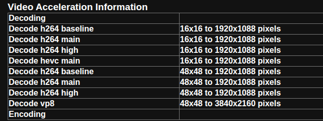

Installed chromium_v136 on Opi5-Plus. Unfortunately v4l2request not enabled as such no vpu hw acceleration with chromium_v136 using mainline kernel linux-6.14.
Was informed the current Debian Chromium builds have v4l2request enabled, amazingfate ppa chromium build does support v4l2request. Tested it before on amazingfate’s Debian-Trixie-hybrid-iso.
Unfortunately not on rockchip soc.
In fact it’s seems not to be a question of stateful /stateless v4l2 api (more a ffmpeg problem) but rockchip devices are using v4l2-request rather than v4l2-m2m for decoders. For pi6 if they enable other video format acceleration it’s just a matter to set media.ffvpx.enabled to false use system ffmpeg for vp8/vp9/av1 decode in firefox. And to compile chromium with use_v4l2_codec=true use_vaapi=false.

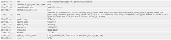

I managed to compile chromium 137. it took about 14 hours on a x13s.
I decided to enable v4l2 and disable vaapi (the code in chromium conflicts, only one can be enabled)
run it with
--enable-features=AcceleratedVideoDecoder,AcceleratedVideoDecodeLinuxGL,AcceleratedVideoDecodeLinuxZeroCopyGL
what went wrong in the past ?

chrome://gpu:
Graphics Feature Status
*   Canvas: Hardware accelerated
*   Direct Rendering Display Compositor: Disabled
*   Compositing: Hardware accelerated
*   Multiple Raster Threads: Enabled
*   OpenGL: Enabled
*   Rasterization: Hardware accelerated on all pages
*   Raw Draw: Disabled
*   Skia Graphite: Disabled
*   Video Decode: Hardware accelerated
*   Video Encode: Software only. Hardware acceleration disabled
*   Vulkan: Disabled
*   WebGL: Hardware accelerated
*   WebGL2: Hardware accelerated
*   WebGPU: Disabled
*   WebNN: Disabled

Chromium_v137 V4l2request does indeed works with this “–ozone-platform=wayland” on Orange Pi 5 Plus with kernel-6.15. But unfortunately it will randomly crash on RK3588 device unless the Chromium build with this patch reverted. This is according to amazingfate with build/maintain the chromium package for Armbian
