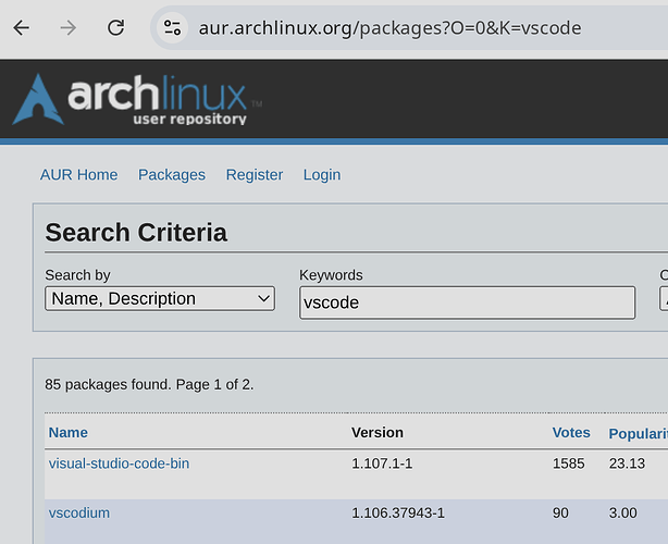

At the moment I check https://aur.archlinux.org/ is not down, I can search packages
