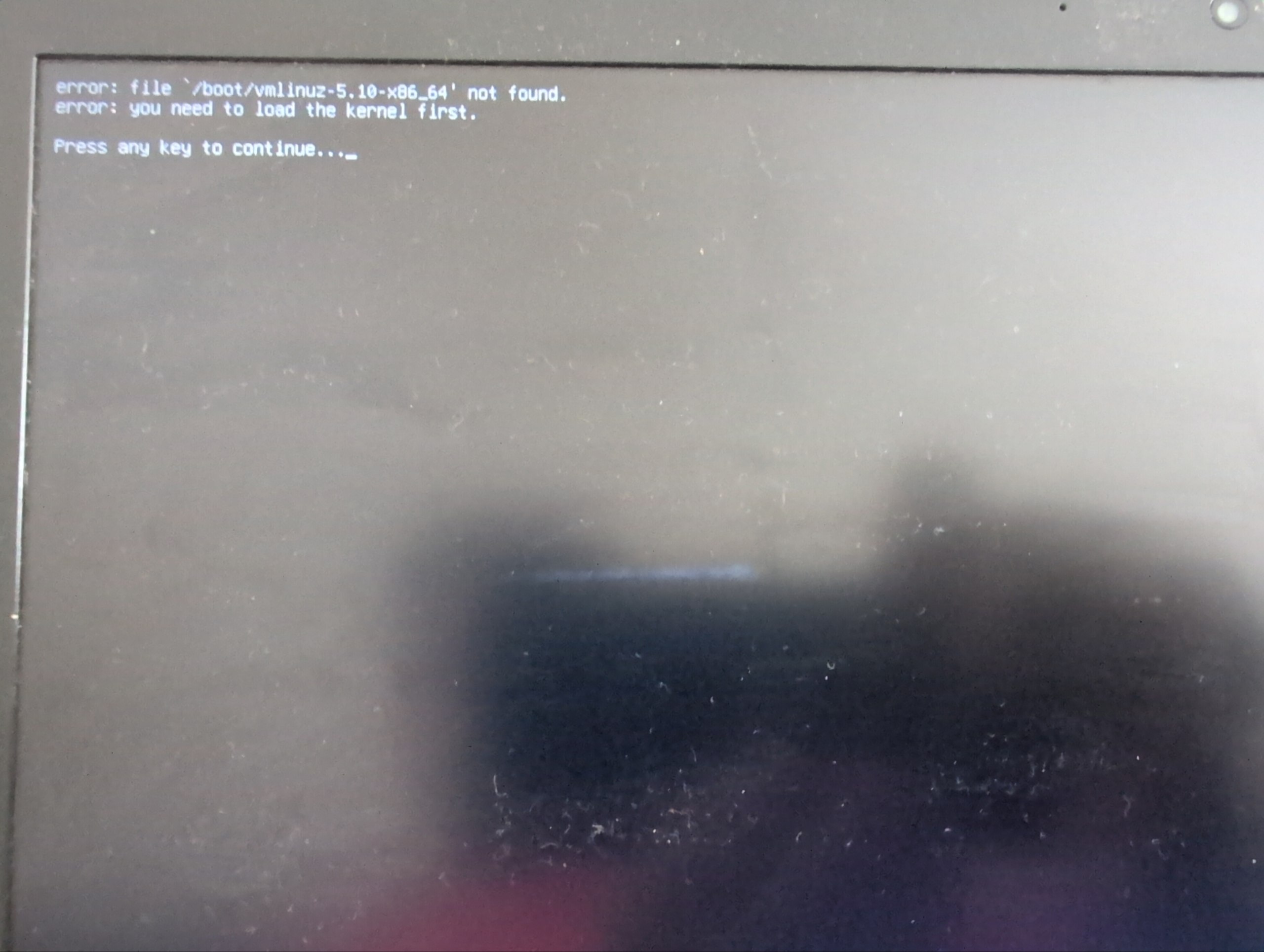

I have an older T460s that I had installed Manjaro on some time ago. I have not updated it for a long time before yesterday. After the update it broke (vmlinuz not found during boot. which is weird, because I don’t think I’ve interrupted the update, but perhaps I’m wrong), and I’m trying to rescue it by booting into Manjaro installer on a USB device (and then chrooting it and so on).

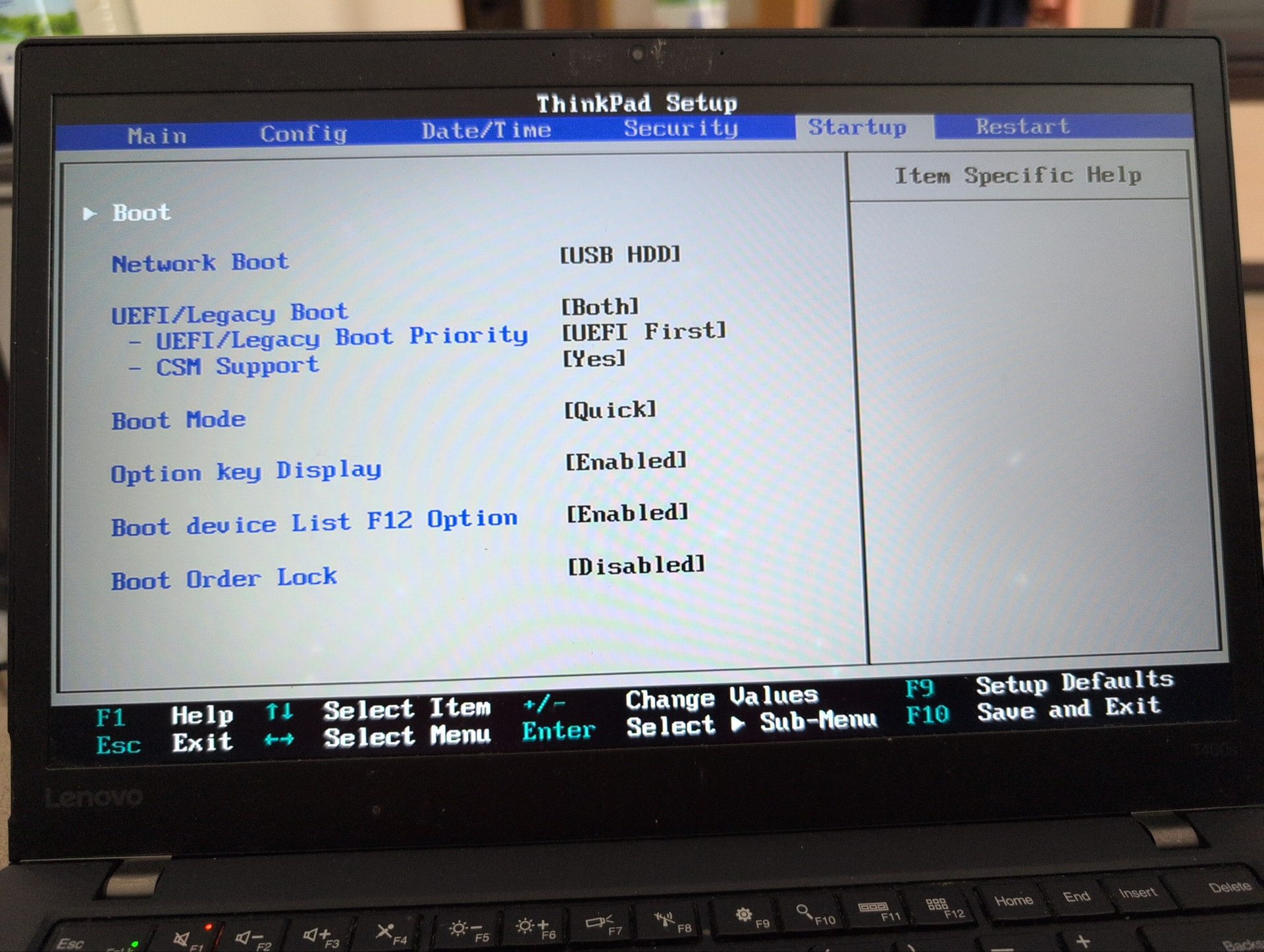

I should point out that it’s normally recommended to disable CSM and set the firmware to (U)EFI only. Maybe the CMOS cell is failing and it lost its settings? :thinking:

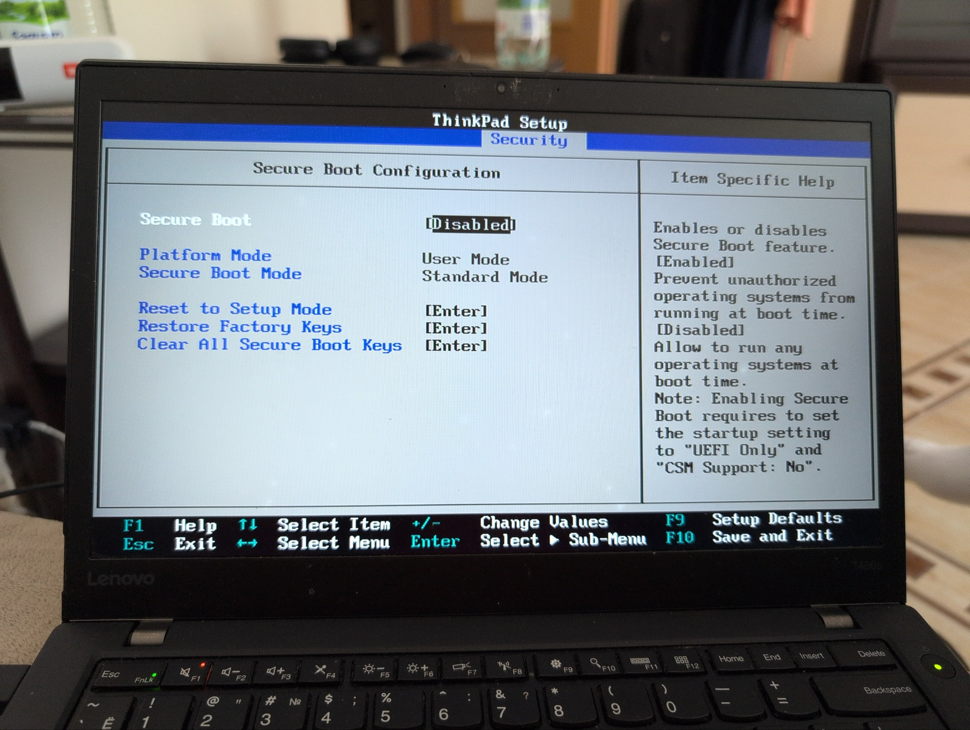

Yeah I’ve already tried whatever I could there. Made sure secure boot is off, played around with boot modes (uefi only, both, bios only), nothing helps.
Yeah I’ve tried doing that already (UEFI only + disabled CSM support) :frowning:
Tried it again just now, still no usb in my boot menu.

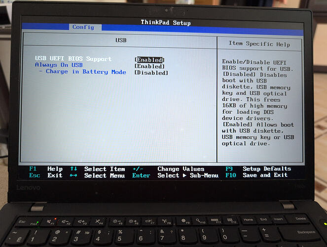

Is there perhaps something like “Security > I/O Port Access > USB Port” in the BIOS? If so it should be set to enabled.
Yep there is, and yep it is enabled.
There is also a USB UEFI BIOS Support option which is also enabled.
And also, I did manage to install Manjaro on it somehow a few years ago (and haven’t changed any BIOS settings since, apart from what I was/am trying to do after the installation broke now), so all those BIOS options must be ok probably..
