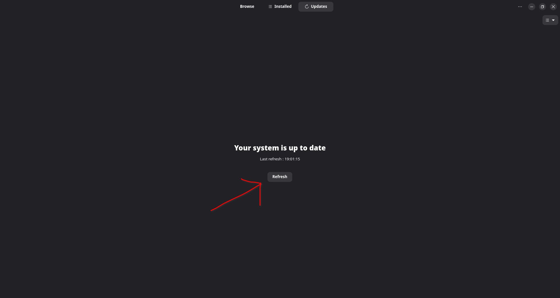

Is there no way to fix this? The main issue here is that what’s written inside the Pamac window “Your system is up to date” directly conflicts with the blue dot in the system tray which implies that there are still updates that are pending to be installed. This is confusing to the end user who doesn’t know which indication is the correct one: “Is my system fully updated or have I missed something somewhere?”
The current manual solution is to click on the refresh button inside the Pamac window and then after about 6-7 seconds later the blue dot in the system tray disappears. I suggest that the refresh button/command should be automatically executed after an update is done so that the blue dot will be cleared on its own without causing any confusion to the end user in the process… (and if there are any further updates, they will be displayed by this action)

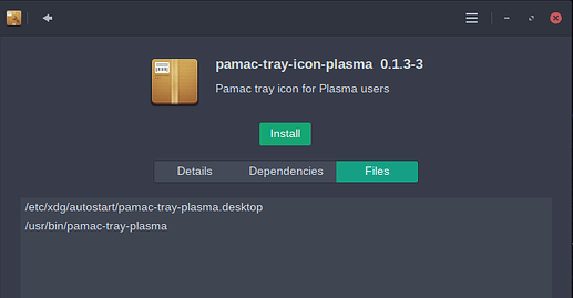

It might also be possible to reload the tray icon
$ pamac list -f pamac-tray-icon-plasma
/etc/xdg/autostart/pamac-tray-plasma.desktop
/usr/bin/pamac-tray-plasma

Pamac GUI can also show package files
