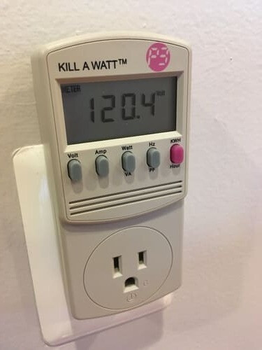

I’ve had one of these for ages though, it did not cost much (measures power and current too):
Makes it really easy then.
