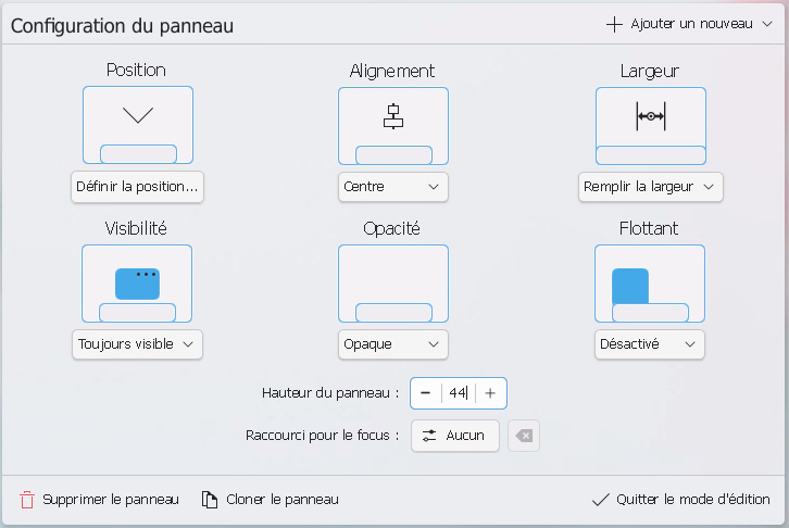

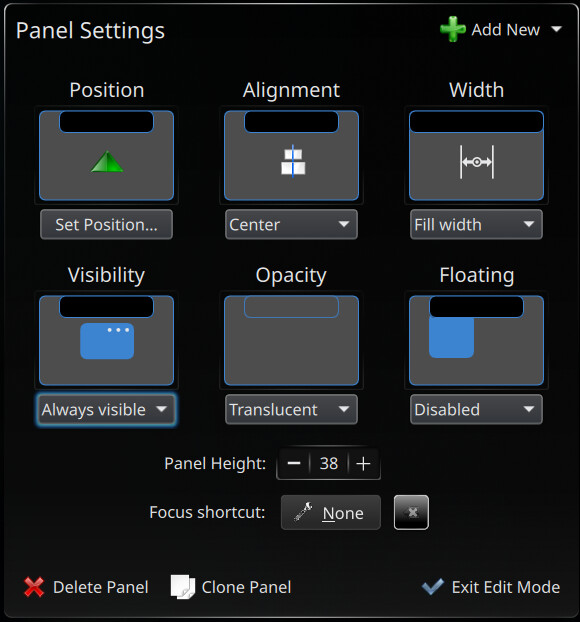

  1. Right-click the panel and enter its “edit mode”. Make sure that it’s not set to dodge. There are several options…:backhand_index_pointing_down:
    • always visible
    • always hidden (will only appear if the mouse pointer is moved to the bottom of the screen)
    • dodge (will duck if the window is too large or placed too close to the panel)
    • et al

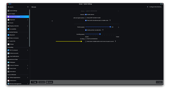

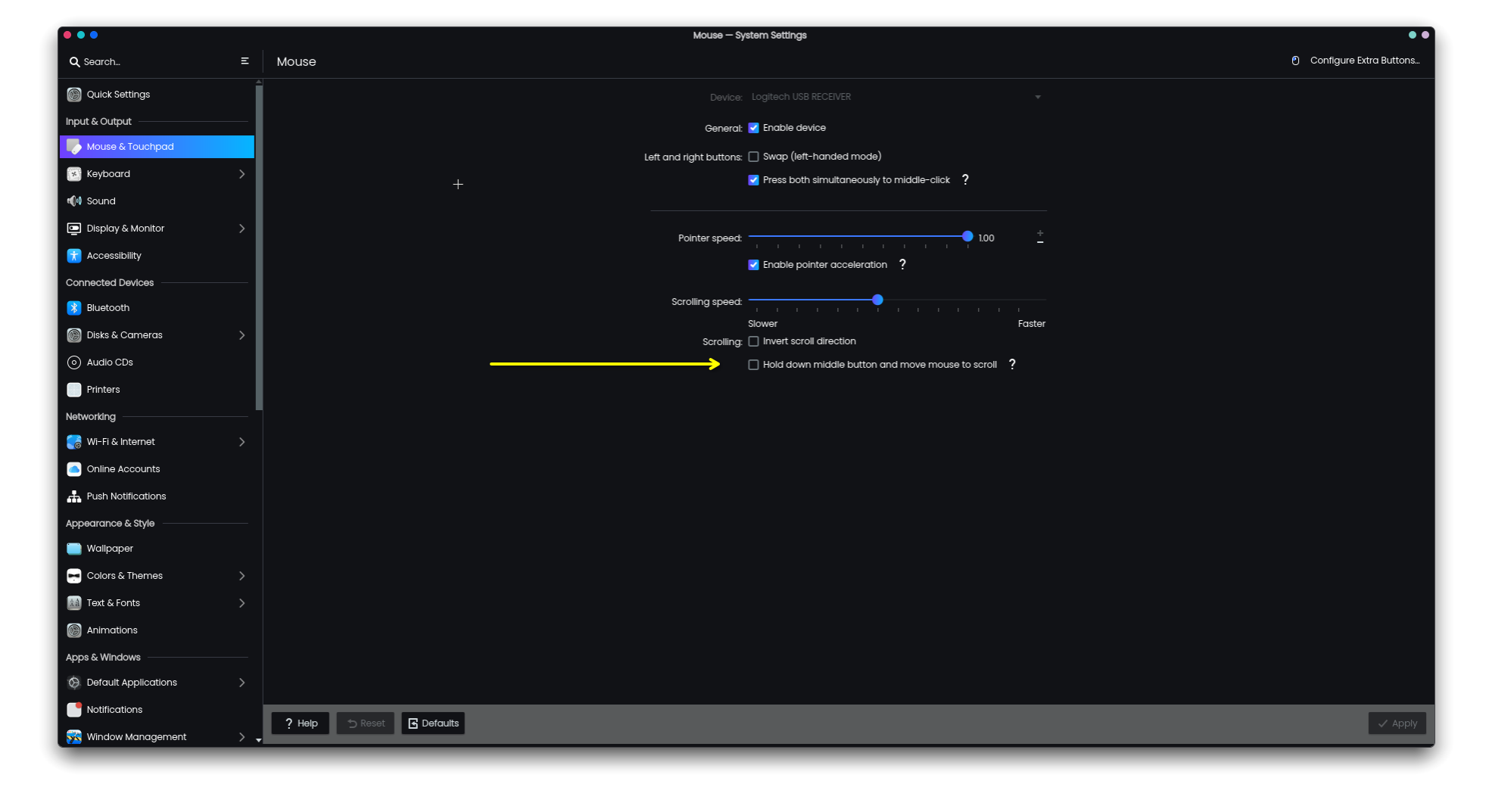

  2. Check whether pressing the scroll wheel on the mouse is set to scrolling, i.e. you press the scroll wheel, and moving the mouse up and down then scrolls through the document — which I believe is a Windows thing. Disabling this setting (:backhand_index_pointing_down:) will probably also prevent this behavior in firefox, provided that it’s not actually a bug in firefox — disclaimer: I don’t use firefox, so I cannot verify this.
Thanks,
The panel is in a fixed position and the mouse settings are just like yours.

In the panel options is Visibility set to “Always visible”?

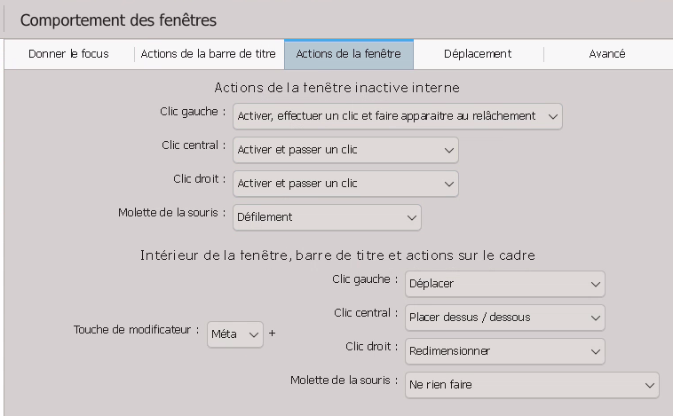

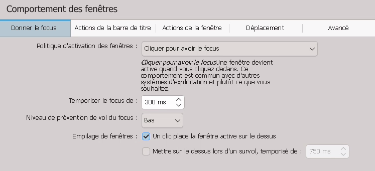

Also what are your settings in System Settings → Window Management → Window Behaviour → Focus?
Likewise what are your settings in System Settings → Window Management → Window Behaviour → Window Actions?
This is what I have, which I believe is fine:
Nothing in Window rules and here are the two others:
My French is caput but I think all those options look fine.
