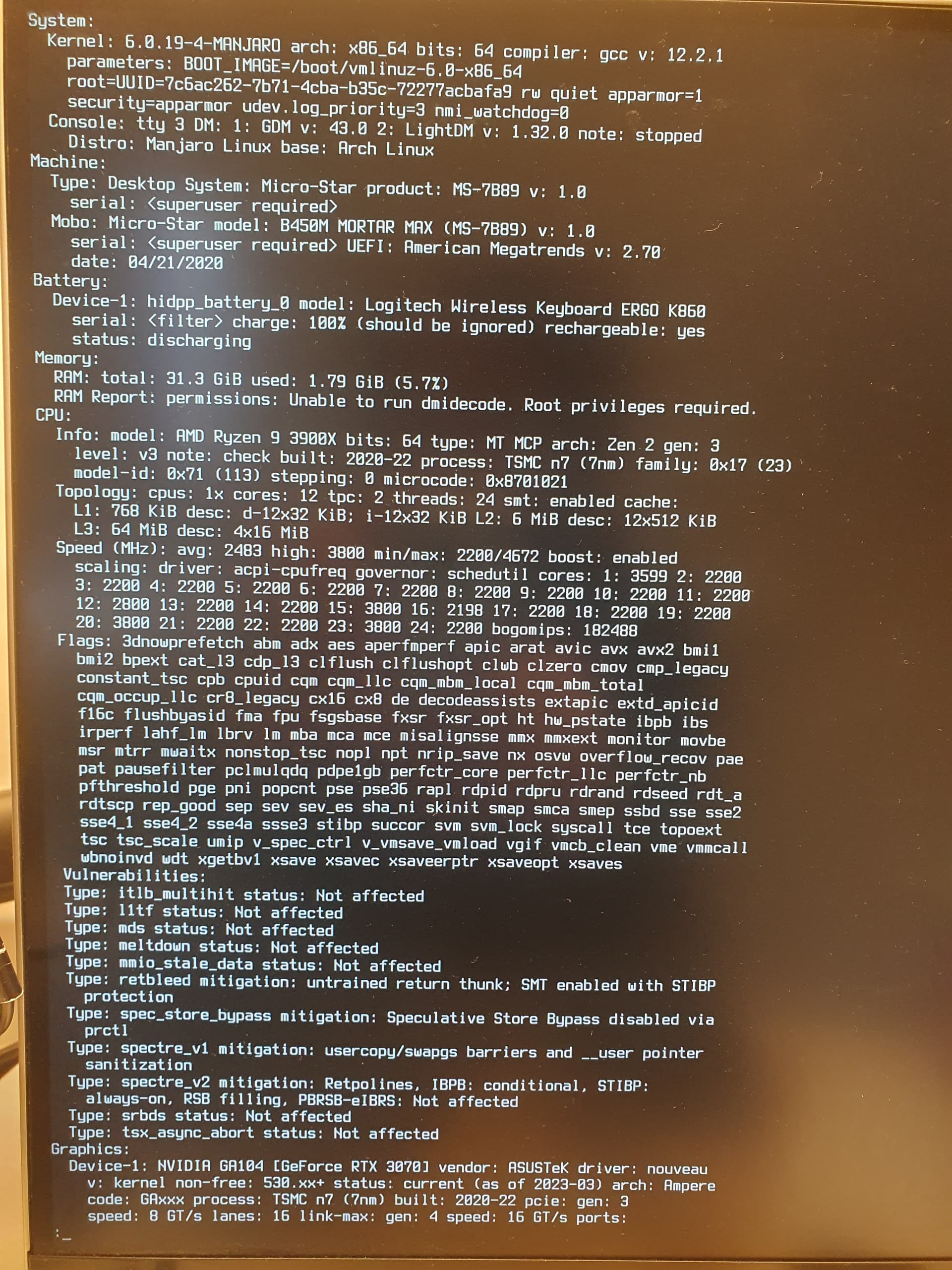

Below is my system info, including a journalctl-log that show some failures. Can you please help me to troubleshoot? I do not umderstand the journslctl output…

post output from:
mhwd-kernel -li && mhwd -l -li
find /etc/X11/ -name "*.conf"
kernel 6.0 is EOL ( no more support ) as nvidia drivers for this kernel version
if possible add kernel 6.1 & 6.2

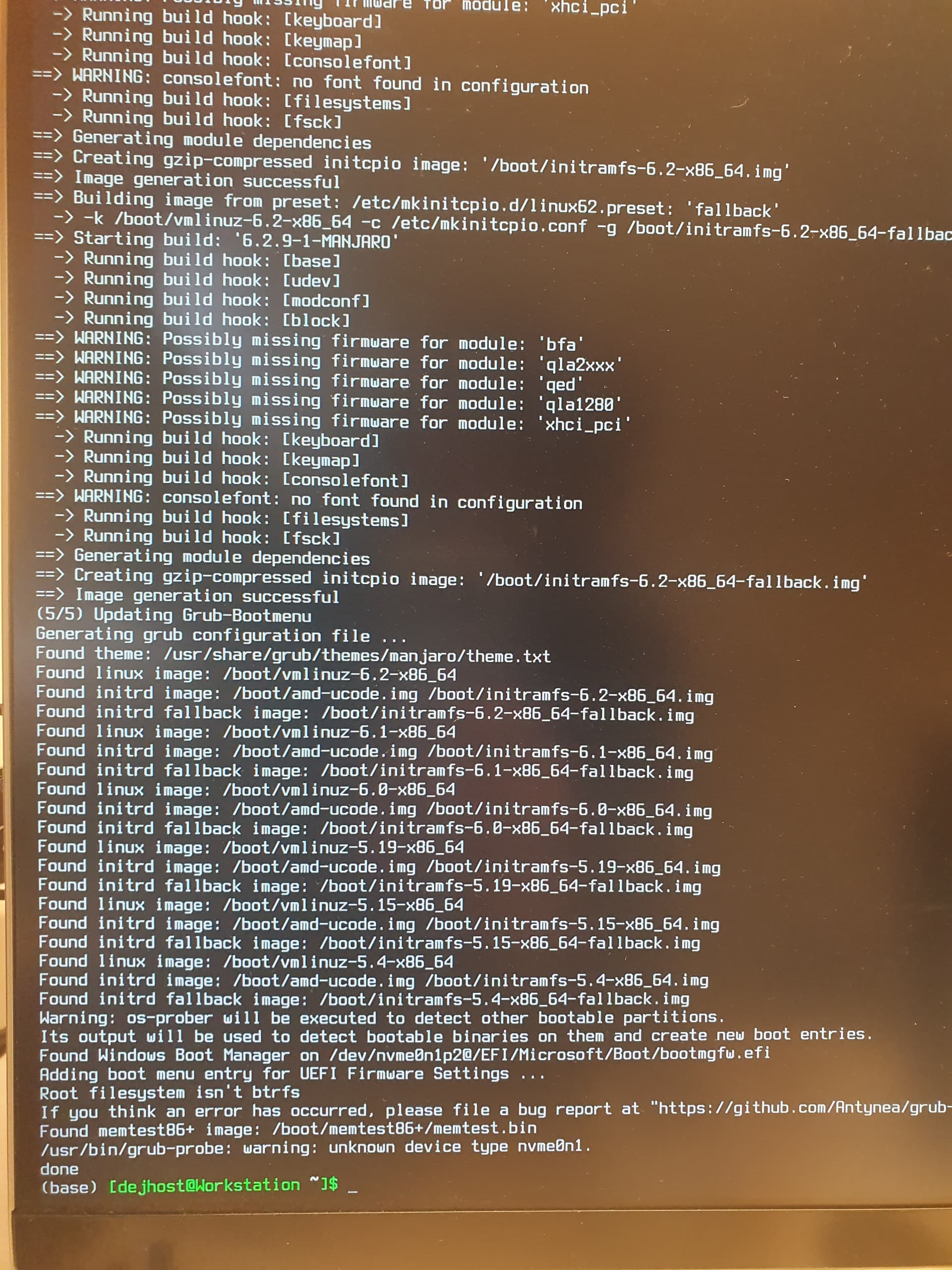

Installing kernel 6.1 went smoorth. 6.2 gave some feedback about my win boot partitions and the unknown device type nvme0n1 (there is only 1 disk in my pc). To be on the safe side, here is a screenshot.
After installing the kernel, I boot into 6.2.9-1 (still not GUI) and remove kernel 6.0.

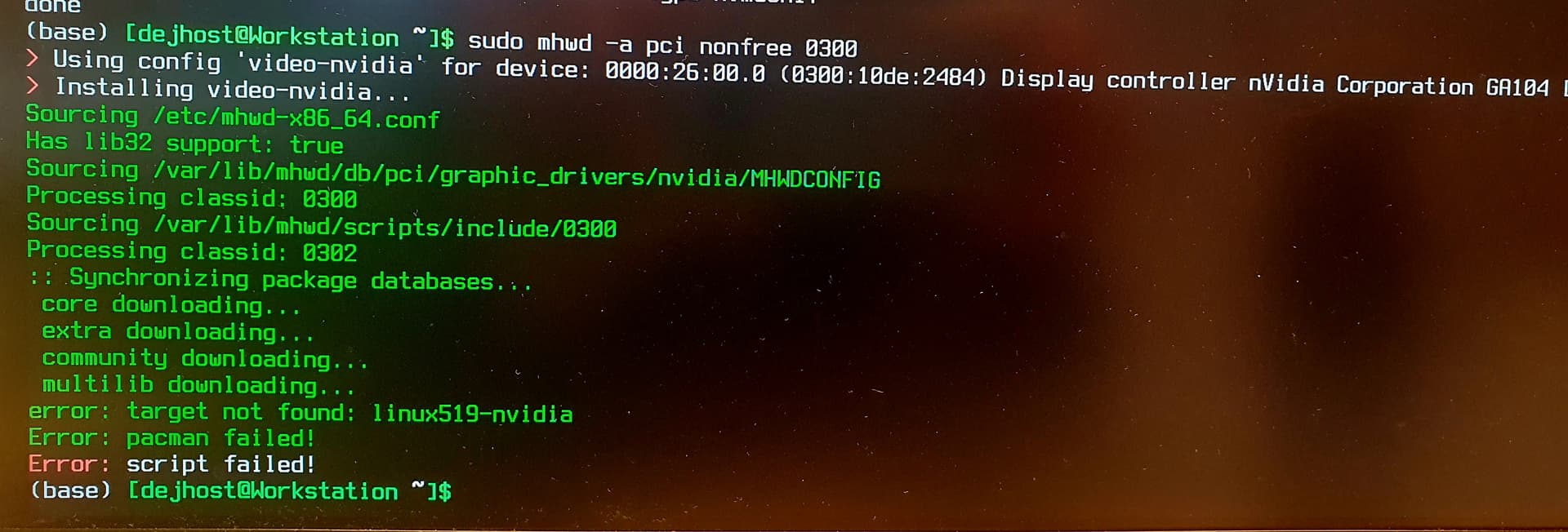

Inan attempt to install nvidia ends like this:

so you will have to remove kernel EOL ( end of Life – no more support )
sudo mhwd-kernel -r linux519
sudo mhwd-kernel -r linux60
boot on kernel 5.15
sudo mhwd-kernel -i linux61
sudo mhwd-kernel -i linux62
check after if some file ghosts stays ( keep only linux 515 , 6.1 and 6.2 )
