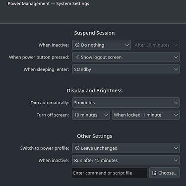

Your initial description is likely the key to a plausible explanation - I am thinking that power management is the likely cause.
The upstream kernel development may introduce small changes in power management and the signal path in the kernel driver module system.
When you make the bluetooth connection depending on the monitor - by using the monitors USB hub - you may have introduced a loop or a race condition.
The most viable option will be to remove the bluetooth adapters dependency on the monitors USB hub - simply move it to the physical computer instead.
