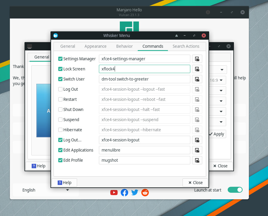

If you cannot access Action Buttons preferences via right-click menu the preferences can also be accessed via the Items tab in xfce4-panel --preferences
I’m right-clicking on menu items and everywhere else and I’m not getting to Preferences.
He meant rightclicking the manjaro logo aka start button.
I tried that and I don’t see any Action Button preferences.
I was referring to the Action Buttons on the panel rather than the buttons in Whisker Menu

Another scenario of lightlocker or not?
From what I’ve read about lightlocker, it could be related. Can lightlocker be removed?
The thing was that not very long ago lightlocker was Removed from the default xfce ISO’s
But, some configuration files referencing it were left on the XFCE profile.
See for example this thread:
(sorry I cant go looking very hard at how it sits at gitlab just now)
