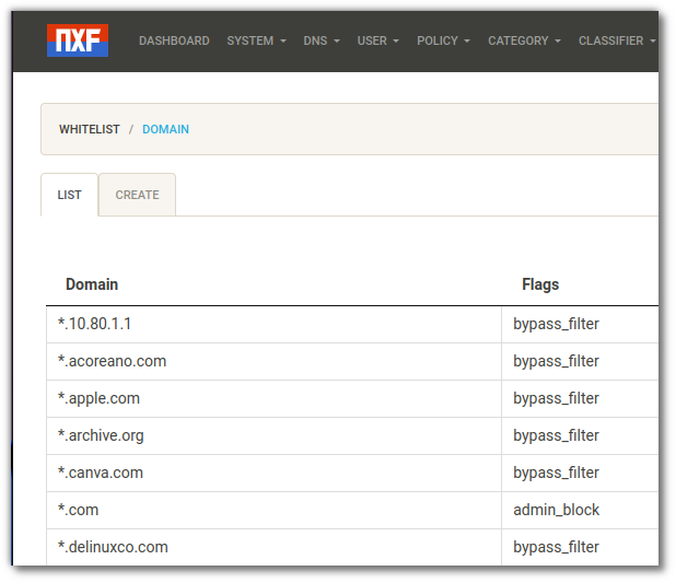

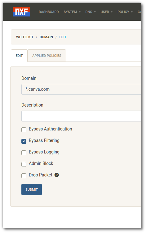

NXFilter, is a DNS filter, once installed you can use it’s gui to configure your sites.
Once both apps are setup you can add items to the WHITELIST, to block all .com site, you would use a wildcard of *.com and set it to "Admin Block", but if you have a certain site that you still want to access, you add another WHITELIST entry but add it as a filter bypass. as an example, if I add canva.com, it would be the only .com site that the machine would be able to access.
Note: in order for NXFilter to work with Unbound, you will have to add a manual entry to NXFilter config, check out their forums for more info.
I have been using this setup for my residence and for my clients and it works well. I even used one system with Manjaro XFCE to setup a streaming server (an auction company that streams their sales), employees kept using it for personal use, now only the streaming host can be accessed, all other sites, they get a nastygram ![]()
