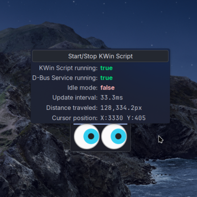

With a 32" 4K monitor it’s even harder to know where the mouse is than it was before. Xfce4-eyes-plugin works just fine (in xfce). Other ways? Yes there used to be KDE mouse-trails, worked really well, and it seems that anything that is really practical getss ‘written out’ :frowning:

The one I use is shake, makes the mouse pointer much bigger.
There is Also Mouse Track, which creates a rotating image around the Mouse pointer, when you press CTRL + META.
Widgets or Plasmoids are unsupported - use at your own risk.
Remember that widgets is not a set-and-forget thing - due to changes in Plasma - they may cease functioning without warning.
