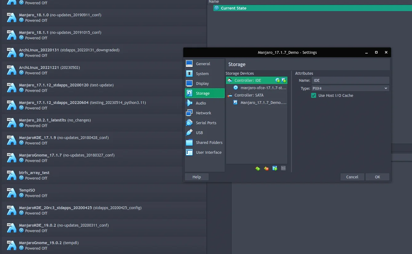

Video showing my auto-update script updating Manjaro Xfce 17.1.7 (2018/04/01) to latest stable (as of today):
NOTE: Not supported by manjaro devs. I use this to maintain manjaro on relatives’ computers. It updates the system every time they start their computers.
Handling of individual package conflicts is hard-coded into the script. I don’t know all possible conflicts, but I add them as I find them.

Omg…don’t tempt me…I don’t have enough time as it is…I promised myself I wouldn’t support updating ISOs further back than 17.1.7…
@lectrode great job. It always depends if you have access to those old ISOs as the hoster tend us to remove them. It took me a long time to ask Roland to give me one of his backups of 0.1 and 0.1.1 releases. Sure more people had it back then. With 0.8 release we started to have Manjaro as base. 0.1 was still an Arch Graphical Installer, which you can find here also: https://archlinuxgui.com
So more or less if you add Calamares to an ISO and make it installable you have an easier way to install Arch. However those ISOs are not pure Arch either, as they come with a pre-configuration and package selection. So in the end it is already a variant of settings you either like or not. Antergos with their Cnchi, which we modified at some point before we used Calamares, provided an install media which acted similar to the ArchISO by downloading the packages from the Mirrors and installed them via a script you configured thru the graphical installer.
Manjaro never joined that cat and mouse game in catching up what Arch changes and maintaining those scripts. Sure we had Architect Installer at some point, but stopped it cos also there we had to maintain all those scripts and profiles. So basically our install media install that what you see in the live session. In the end some did not agree on our examples and created spins with their take on how it should look like.
So now you have installed Manjaro based on the ISO media you used. It works, you can browse the net, do some productive stuff. But wait, there is something missing, I need software, more apps, different apps, maybe delete some of the pre-installation.
So ya, the ISO is not the full distribution of Manjaro. You have Mirrors with a lot of more packages. To get those you have to match the state of the Mirrors and the state of what you have installed. That is why you first have to update the system to sync to the state the Mirrors have. Sure you can do that with older ISOs and have fun fixing things or you get the latest, which are more nearer to the state the Mirrors have
