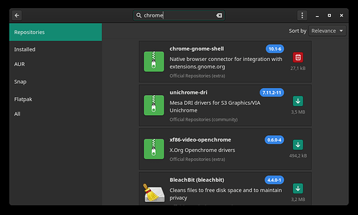

Maybe there is gonna be a change in the text to better reflect the search,something like this
But nothing official yet.
It was explained to me that regardless the position of Repositories, the global search will not change if AUR is enabled, except that was removed for now. My point was that each time someone types or edits the search in the search field, to default to Repositories, even if some other category is selected, so you first type, and then you can click on category and get the result, so when you would click on All with AUR enabled, the search query would be a complete word, but also i was told that it will not work that way due to the way the code is …
