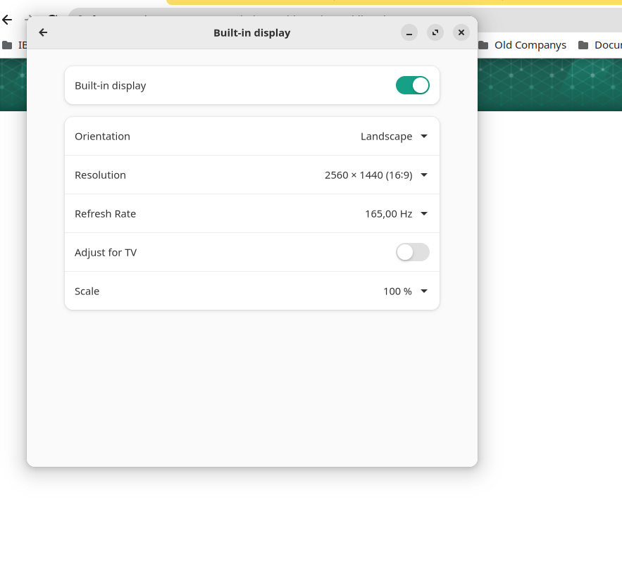

Yesterday i install Manjaro and a install optimus manager because my laptot have 2 graphics card. RTX 3060 and AMD GPU. But i cant change resolution for laptot screen . When i tried i got this window and is very wierd. The default resolutio for laptot screen is 2560 x 1440. But i wnat change too 1920 x 1080. If i start nvidia-settings tells me that is manged but PRIME Display and i cant do anything.

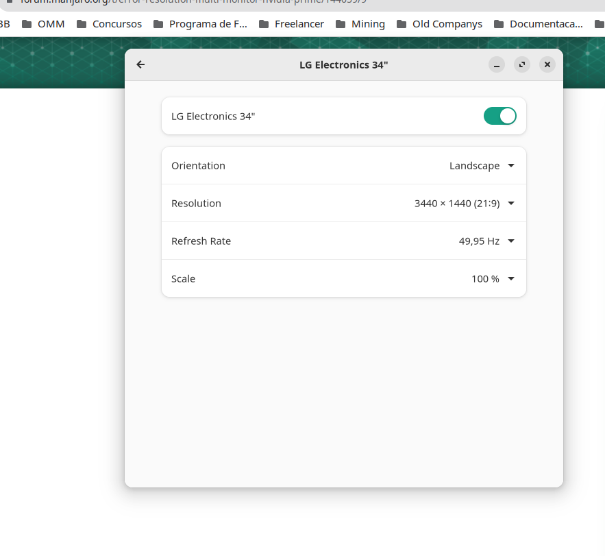

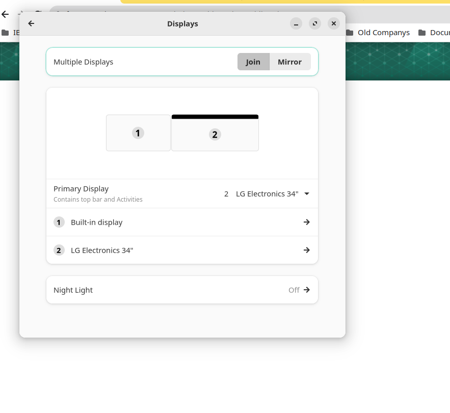

Even i am all fine. I can change resolution for the second monitor. I think is something related to the xrand and the position. But i dont how to fix.
check your system-settings. there should be the panel-setting where you can choose if the displays are merged to one or separated and separated to which position.
they are merged to one display actually.
edit: i can see at the left side the panel setting. there are the settings included, you’ll have to check out what you want.
The seem to be merged because of print screen. Here is my display settings.
i’m on kde but it should be similar. the first picture. use the mouse, place it on display 2, left click and move it a little bit. changes ?
No changes. What version of NVIDIA driver you are using ?
the actual, same than yours. it’s not a question of the driver. you’ll have to check how to set up the displays in gnome. while i’m on kde i wouldn’t be a help for this. but there are so many tutorials for example at youtube.
