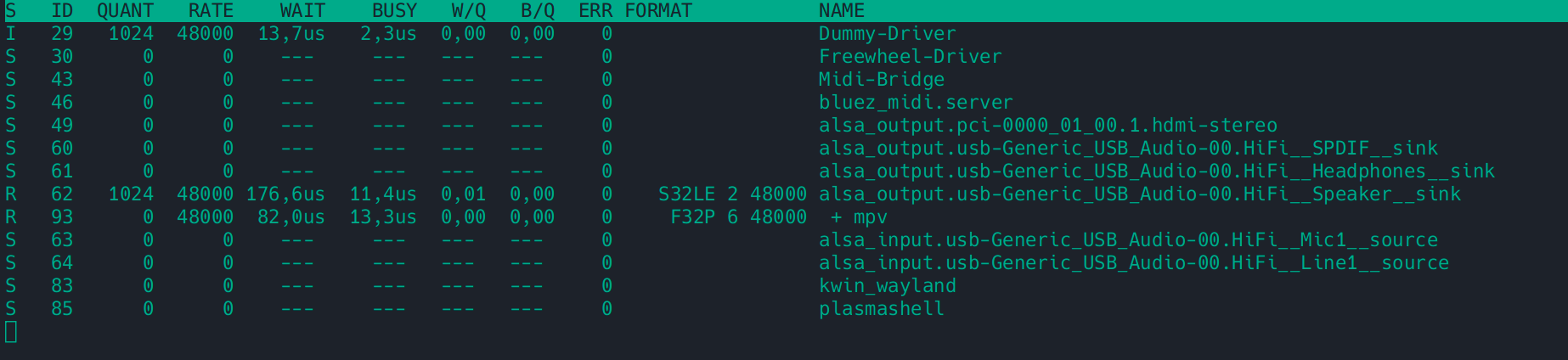

check with pw-top

found how to interrogate Alsa and it’s negotiating the right format for the ZXR (S32LE)

cat /proc/asound/card0/pcm0p/sub0/hw_params
run this as user in a terminal
output for a ZXR:
access: MMAP_INTERLEAVED
format: S32_LE
subformat: STD
channels: 6
rate: 96000 (96000/1)
period_size: 2048
buffer_size: 32768
your device may not be card0 though
find your device using:
cat /proc/asound/cards
I haven’t forced anything, so i’m guessing this is a driver negotiated config between ALSA and the ZXR
only thing i’ve changed was in Pipewire, adding more supported sample rates to avoid resampling as much as possible
