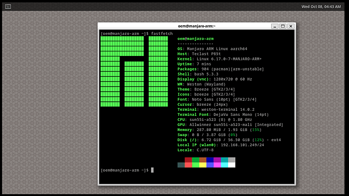

Summary
Good news everyone!
HDMI running.

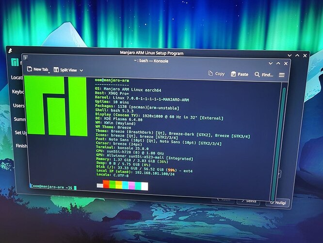

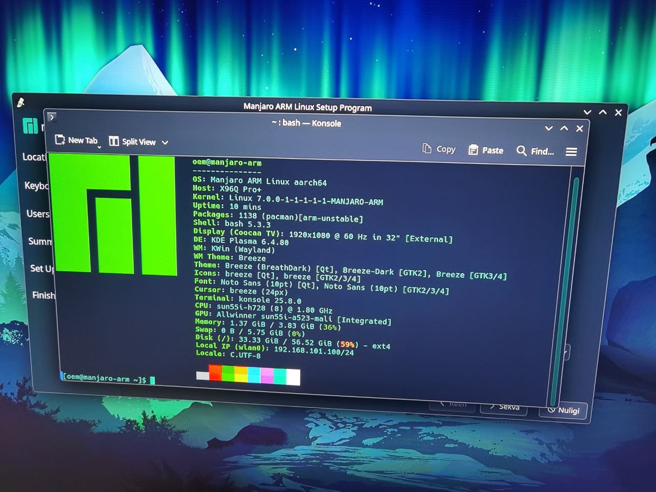

I have video output now!
The panfrost module has been backlisted. Maybe you have installed something that makes panfrost work with display?
