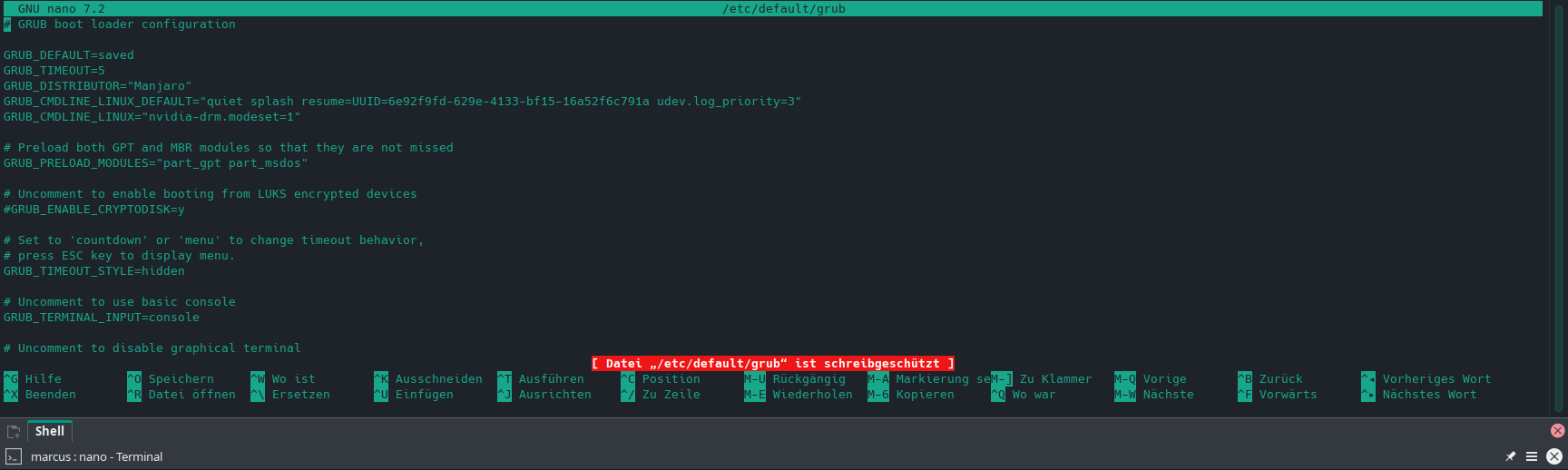

I use a GTX 970 under KDE Wayland without problems, but had to do the following:
Under /etc/default/grub
I have nvidia-drm.modeset=1 added, then looks like this:
Plasma/Wayland/Nvidia
In /etc/environment:
GBM_BACKEND=nvidia-drm
__GLX_VENDOR_LIBRARY_NAME=nvidia
I don’t remember where I got this setting from. :sweat_smile:
Since then Wayland runs without problems under KDE. But with Nvidia cards the night mode does not work under Wayland yet.
Maybe this will help someone here. :slightly_smiling_face:
