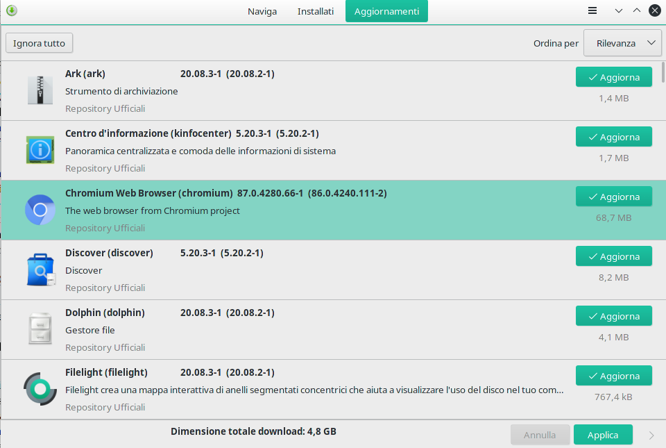

I noticed something else, but looking at the image, do you think the packages I need to update are newer, or is it downgrading me to older packages?

Also, do you notice from the screenshot that the packages are upgrading, or are they going back to the previous version? I don’t understand, it seems to me that they are involving.

The number in parenthesis is the installed version. The number before that is what’s going to be installed.

A ok ok, I thought it was the opposite, i.e. the number without brackets was the one already installed (because it comes first) and the one in brackets was the one to be installed.
